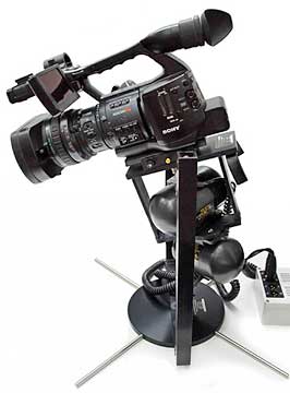

    There's a small company that's been at NAB the past two years. They rent small and medium gyro stabilized units that mount efficiently.
    It's called a "Tyler Minigyro". (818) 989 4420, tylerminigyro.com

    Can I undersling the Tyler mini gyro somehow?
    I will probably have an ATM dual KS8 gyro rig with me, but there is no real way to get the camera closer to the water with the ATM rig, that I know of. The deck is already a couple feet off the water, and the ATM rig will add another couple feet.
