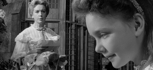

    If you wish to see some stunning deep focus compositions (and well, stunning compositions period) then check out "Last Year at Marienbad" by Alain Resnais. It is one of the most stunningly-composed motion pictures in history. Resnais is nothing if not a structuralist, and every one of his images is highly organized.
    Here's a typical frame I quickly found that illustrates David's point about a reflection in the mirror from his comments on "The Shining."
