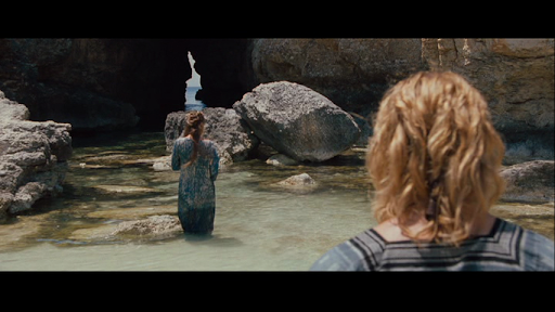

    I read this thread a few days ago, and really started looking for deep shots. I was surprised to find a lot of great examples of deep focus shots that really tell a story in the movie Troy.
    Achilles talking to his mother. The foreground is just a tiny bit out of focus, but the shot has a lot of depth, following the dark cave into the sunlight. Achilles will go to war, and die, but in the end, he will be remembered for all of eternity.

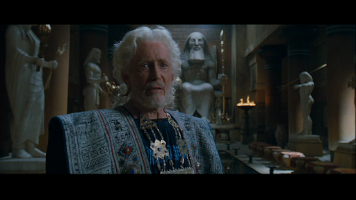

    This is my favorite one. All of King Priam's decisions are made based on what he believes the Gods' had willed. It is his ignorance that costs him his life, his kingdom, and the war. Here we can see the Gods' influence on King Priam, as the statues are clearly behind him and above him. The fire in the background could also foreshadow the burning of Troy as well.

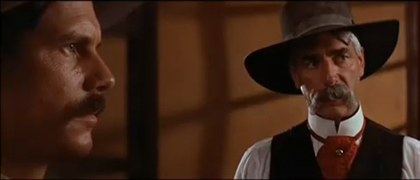

    Quote Originally Posted by David Mullen ASC View Post
    Deep focus is particularly powerful in b&w where you aren't distracted by extra color information coming into focus and can create a graphic image:
    David, I'm curious if the example above in "Citizen Kane" could be the use of a split focus diopter, or if that technique was in use back then (early 40's).
    Below is a scene from "Tombstone" in which I believe the technique was used briefly:
    Thanks again for your input.
