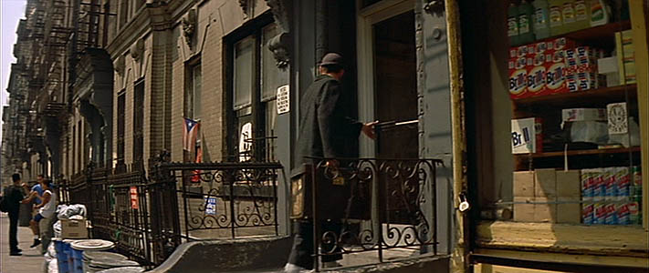

    Here is a more severe example of wide-angle 35mm anamorphic photography with a lot of barrel distortion:
    You can see the similarities to 65mm Todd-AO photography:
    To some extent, this distortion was mellowed/masked by being projected on curved screens in the past.
    David Mullen, ASC
    http://www.davidmullenasc.com

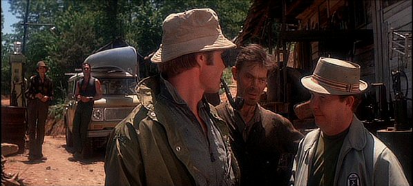

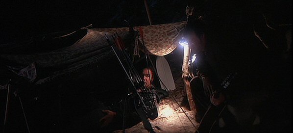

  9. #3039
    "The Informant!" used Double Fogs, I think a #1/4 or #1/2.
    Vilmos Zsigmond used Double Fogs on his early movies such as "McCabe & Mrs. Miller". In "Close Encounters" you occasionally see the effect of Low Cons and Double Fogs.
    Low Cons or Double Fogs, not sure which:
    Some people still use the #1/8 Double Fog (the lightest) now & then for select shots when they want that halation.
