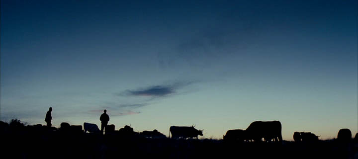

    The Attenuator doesn't have a transition line to a clear area, it just has a gradual change from darker to lighter throughout. You'd use it when you don't have any place to hide or blend the transition in a regular grad.

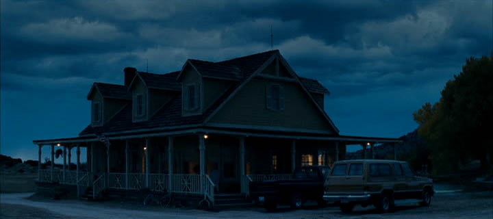

    For example, in "The Astronaut Farmer" I used an ND.60 Attentuator here for a overcast day-for-night shot because I wanted to darken the sky but didn't want to see the grad line go through the peak of the house:
    Here I used a regular soft-edge ND.60 grad:
    David Mullen, ASC
