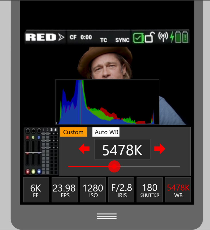

    Quote Originally Posted by Björn Benckert View Post
    One thing, when you change deg or exposure time you want to see the histogram / goalposts and RGB overfill lamps at the same time. Same goes for color temp settings etc. If the histogram is not there when you scroll the Kelvins how will you know your colors are right if the histogram is not there ?
    Same for exposure, let say you want to expose 1/2 a stop under clip.... Then you want to see the RGB lights and dial down until the lights go out.
    Compare to current DSMC2 menus the above is simply useless. Think atleast this should be a step forward, no?
    Very good point Björn. Using the physical buttons, I assume you will be able to select the setting that you want to change and then use the UP and DOWN buttons to change it without bringing up the overlay, so the histogram will still be visible. Not sure how this functionality could be mirrored for touch operation. My first thought was touch and drag left to reduce and right to increase. But theres no space to the right of the right hand button or the left of the left hand button. Edit: with Alexandre's design with the buttons just below the preview, touch and drag up or down could adjust settings.
    Rand's idea might work, but as far as I know there are no preset buttons on the camera (wish there were).

    Quote Originally Posted by rand thompson View Post
    Bjorn,
    Like Stanly says, it such a tight display screen. The only thing I can think of , and excuse my rough draft of this, is to have the Histogram as an overlay that can be assigned to a preset button on the camera to turn on and off and movable like below. Next have the menus so that they can be "dockable" or "undockable" like below where from the main menu accessible from the "RED" emblem, I chose to make the menu "undockable" so that the Custom White Balance box wouldn't cover up the Goal posts. You can still see the affect on the image at the same time. Or the location of the menu settings at the bottom where just restricted to the area I show below.
    I like that very much Rand, I took the liberty to to test it also in my mockup below ; )
    To keep things simple and accessible the histogram could even be attached to the shutter change UI. So the appropriate tools appear when you need them. Following the same design principle, an RGB waveform and vectorscope could appear when you change color temp!

    Alexandre,
    That looks great and it frees up space that can be used for other more important/ more frequently used functions.
    Yeah, group those tools together that would logically help the user get more precise corrections and more repeatable results.
    Also, I would keep it the size you have but place it against a black or more solid background. With the different images that will come across the screen a transparent version could be less readable against some scenes than others.
