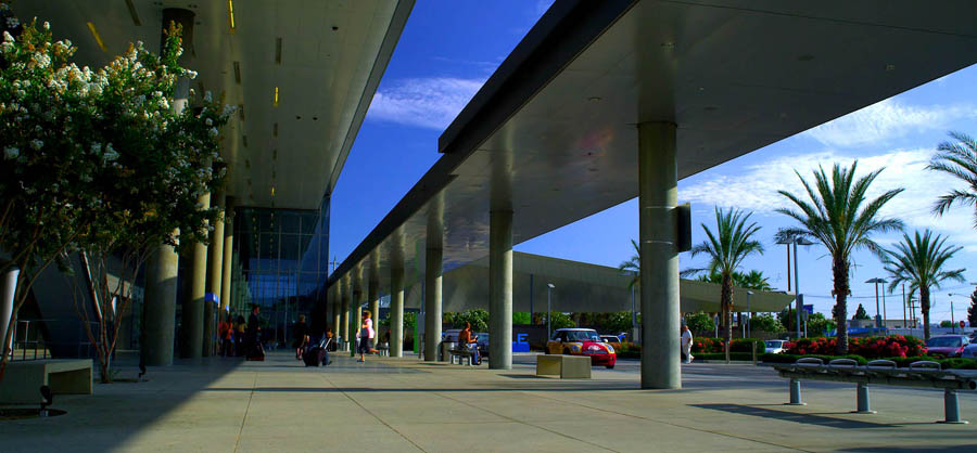

    We spent Monday at the Van Nuys Flyaway station doubling for an airport – I was worried about how we were going to do the scene where the main character gets picked at the curb in front of the airport, with all the restrictions these days, but this modern station doubled quite well for an airport.

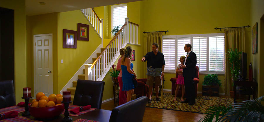

    We were in another suburban subdivision on Thursday shooting a scene inside a tract home, and then moved several blocks uphill to a bigger house to shoot a house party. I had a diffused 18K HMI coming through a window in the tract home for the daytime scene plus some soft fill from bouncing an HMI Source-4, but most of the real illumination came from the natural daylight in there.

    I only have a few innocuous wide shots to post:

    Quote Originally Posted by David Mullen ASC View Post
    David,
    What did you use to light this, 18k or 12k day light?

    It's a 12-light tungsten with 1/2 Orange to match the sodium streetlamps, though in this particular angle, you can't see the orange streetlamps.
