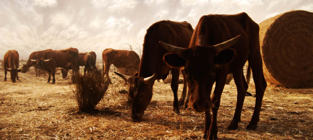

    Monday and Tuesday involved bring live cattle on the landscape set on Stage C. We had a grassy plain on Monday which infortunately, though the grass was spray-painted brown, seemed to drive most of the cows nuts, running around the perimeter (which is a plywood ramp leading up to the backing, not designed for the weight of multiple cows, though it held up) and eating the brown grass and brown leaves on the set. We ended up taking most of the cattle off of the set and just using a very calm milk cow in two scenes.

    The prairie set was turned into a cow pasture on Tueday, with a dirt floor covered with bits of straw and surrounded by fencing. This was a lot better for the cattle we brought in, compared to the open prairie space. The set was full of cattle, which was interesting to say the least. Later we shot a scene in an empty pasture where a farmer stops our main characters, crawling on the ground, from stealing his cow pies, firing a shotgun in their direction. I lit the two manure salesmen in frontal hard light so I could have the farmer throw a shadow over them. Their POV of the farmer was therefore a low-angle with the sky and sun behind the farmer. To get the shot, I put a 12’x12’ painting of the sky above the farmer’s head, tilted down, and cut a hole in it so I could stick a 1K Parcan through it for the effect of the sun hitting the lens.

    This Nikon snapshot is just proof we put cattle in the set:
